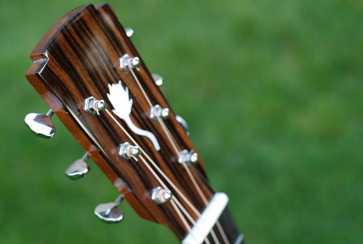

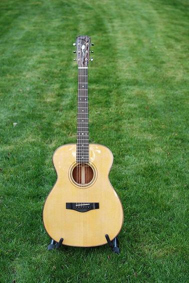

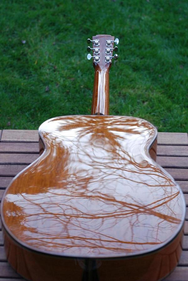

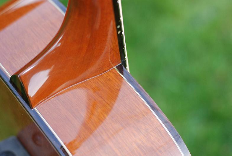

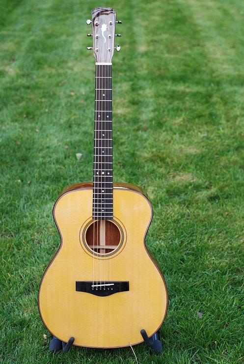

After lurking around sites like OLF for years and reading everything I could find, I fianally took the plunge.  Made lots of mistakes both in design and the work, but am happy with the results.  It sounds great. (IMHO)
Honduran mahogany back and sides
Sitka top
Macassar ebony binding and trim
Gaboon ebony fingerboard and bridge
Everything was made from scratch from lumber, but tried to keep design fairly simple on the first one.  Thanks to all that post here.  You didn't know it at the time, but were a big help in figuring it all out.

You know it's not very nice to lie about the number of guitars you've built on your second post.    I swear that looks like it could be your tenth or twentieth guitar! Nice job!

Doug, that's a fine looking guitar, with what appears to be a very good finish.
What did you finish the instrument with?

Thanks for the kind comments.  The finish is McFadden's nitro laquer.

GREAT lookin guitar!
I'm interested in how you finished the guitar also. I love the shine !

Nice job on your 1st Doug! What kind of tuners are those ?

The tuners are Grovers.  I like the vintage look.
The approach to the finish was pretty much by the book nitro.  I added amber tint, again looking for a bit of vintage affect.  I wet sanded from 600 through 1500 and then machine buffed.  The whole cut and buff process took about 4 hours.

Very tasteful and clean throughout; I really like your headstock shape.

Very very nice, great looking macassar ebony bindings, did you also make the purflings from lumber as well?
